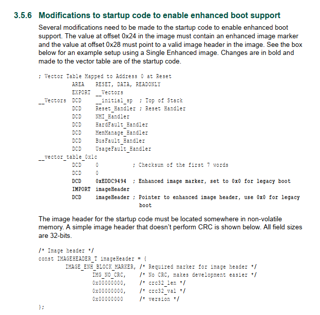

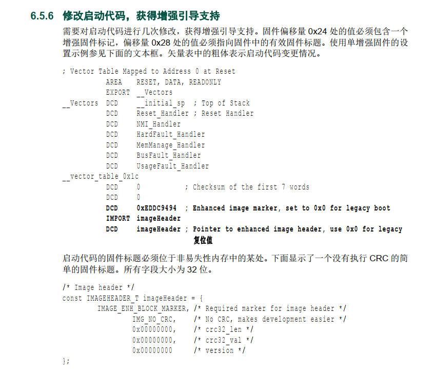

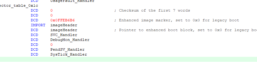

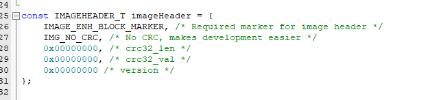

When I read the manual, I saw that I need to change the firmware to dual enhanced firmware in the boot program, as shown below
I use MDK, what can I do to achieve remote upgrade?
Hope you can reply as soon as possible
