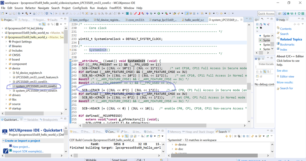

xiangjun_rong
Hi, Eugene,
This is the code for the example.
The SystemInit() function is defined as the second fig. So in secure mode, it is okay to call the   SCB->CPACR |= ((3UL << 0*2) | (3UL << 1*2));
Hope it can help you
