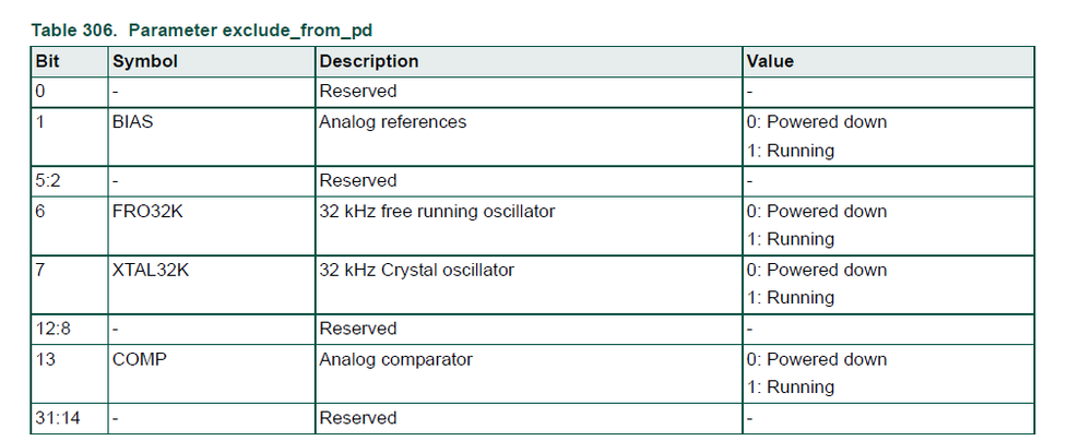

Hi !
Does it possible to set Param0: exclude_from_pd in API  POWER_EnterPowerDown for be able to backup GPIO peripheral ?
Or really it is down in way that during PowerDown mode output pin state should be maintained by PU/PD registers for
conserve power and keep state of GPIO is too time consuming ?
Eugene
2,215 Views
soledad
Param0: exclude_from_pd is only for the following analog peripherals, not for GPIO.
Soledad
