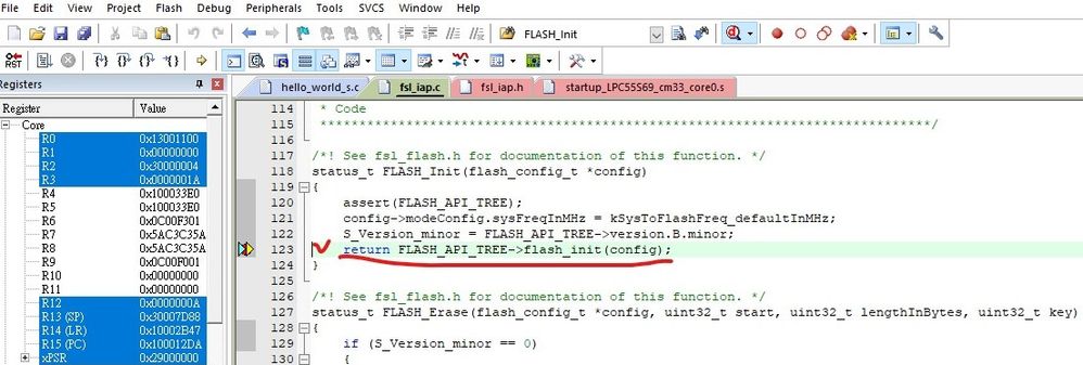

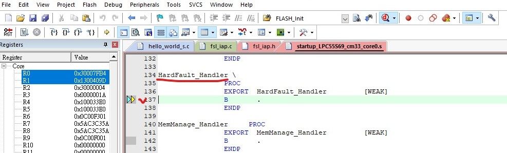

yorktsai
Hi Sabina,
I have a similar problem, I want to do FLASH_Init () directly in Secure world, but the program executes return FLASH_API_TREE-> flash_init (config) and jumps directly to HardFault_Handler. I don't know what caused it, can you help me answer it?
