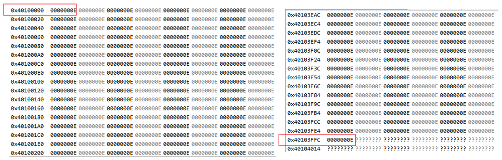

diego_charles
Hi Eugene,
1 Regarding your  last question I have some  results to show:
  I powered my board (with the  LPC55S69 rev1B) and flashed my code.
  After that, when the USB RAM  was gated:
  CLOCK_EnableClock(kCLOCK_UsbRam1);
 I  find out random values , they are expected after a power up.
Moving on, I  decided to initialize the USB RAM with values different that zero.
//this loop will  write from 0x40100000(USB RAM base address ) to  0x40103FCC
    for (int i = 0; i < (FSL_FEATURE_USB_USB_RAM/4); i++)
        ((uint32_t *)FSL_FEATURE_USB_USB_RAM_BASE_ADDRESS)[i] = 0x0EU;
Then, I confirmed  the success on this :smileyhappy:
Finally ,  I noticed that  after  a  sotfware reset, the USB RAM  retained  my initialization.  This may suggest that the USB RAM is not initialized by the MCU or by startup code, as you mention. Even after I flashed another project the USB RAM retained my previous initialization.
I hope this helps!

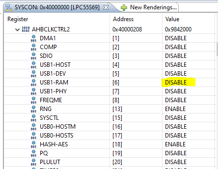

diego_charles
Hi Eugene,
I apologize for the delay,
Using MCuxpresso, you can switch the debugger breakpoint from main to ResetISR. Then open the peripheral view of the  Syscon ->AHBCLKCTRLx registers to check their clock status.
For example,  AHBCLKCTRL2 ,we can see that  the USB_SRAM is dissabled  at the beggining of the application .
