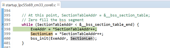

When reboot the program, startup code initializes and zero USB_SRAM area.
please take a look at your ld file, and startup source code.

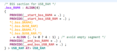

ZhangJennie
Eugene,
I use led_blinky demo.
in debug.ld.we can see BSS secion for USB RAM
.bss_RAM is defined in __bss_section_table,
Have a nice day,
