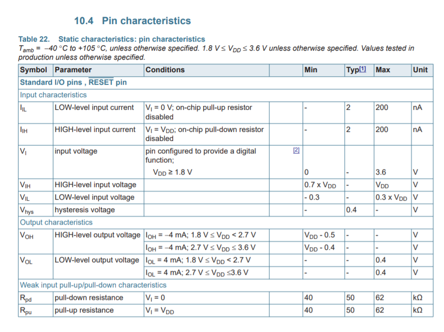

We have plan to use GPIO pins as part of GINT0/1 group for wakeup MCU from Power-Down mode.
But it is not so clear from DS what kind of sensivity those pins have ?
What kind of minimal edge can be detected, is any debounce or glitch filters there and etc.
Do you have extra info about it ?

Hello Eugene,
In the datasheet the pin characteristics are described.
The high level input voltage is the voltage level necessary to send to the device for it to read a logic high. The low level input voltage is the voltage level necessary to send to the device for it to read a logic low. Wake up pins can be configured as rising or falling edge.
