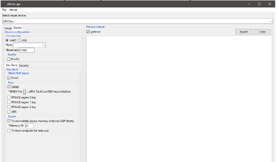

4. Program configuration for puf keystore (puf_cfg.png attached)
5. Program configuration for secure bootloader (secureboot_cfg.png attached)

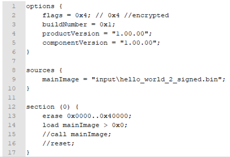

Hi Derek,
thanks for your reply.
In previous post I had .bd file content for SB2.0, right now below is .bd for SB2.1.
There is additional option secureBinaryVersion. Please test updated .bd file with this option.
Secure_FW_version and NS_FW_version checker is new functionality. It will be available from elftosb version 5.1.16 and higher. It is not released yet in SDK2.7.0 for LPC55S69. Example usage of this functionality is below in .bd file. You will be able to check version and SB file will process only when checker will return true (version_check sec 0x2 >= Secure_FW_version)
Example of use (Encrypted + Signed SB):
   1 root key
elftosb.exe -f lpc55xx -k "sbkek.txt" -c "commandFile.bd" -o "output.sb2" -s selfsign_privatekey_rsa2048.pem" -S "selfsign_v3.der.crt" -R "selfsign_v3.der.crt" -h "RKTH.bin" "input.bin"‍
   4 root keys
elftosb.exe  -f lpc55xx -k "sbkek.txt" -c "commandFile.bd" -o "output.sb2" -s private_key_1_2048.pem -S certificate_1_2048.der.crt -R certificate_1_2048.der.crt -R certificate_2_2048.der.crt -R certificate_3_2048.der.crt -R certificate_4_2048.der.crt -h "RHKT.bin" "input.bin"‍
SB2.1 .bd file content
options {
flags = 0x8; // 0x8 encrypted + signed, 0x4 encrypted
buildNumber = 0x1;
productVersion = "1.00.00";
componentVersion = "1.00.00";
secureBinaryVersion = "2.1";
sources {
inputFile = extern(0);
section (0) {
version_check sec 0x2;
version_check nsec 2;
erase 0x0..0x40000;
load inputFile > 0x0;
I hope this can help your issue.

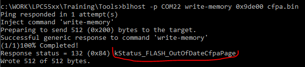

tomas_voda
Hi Derek,
I tested attached certificates in SDK and all works. Hopefully I found your issues.
1)  Issue with secure boot
   I expect your issue for secure bootloader is due to incorect CFPA page modification.
   "6. Read CFPA page (0x9DE00) and set byte @ 0x9DE18 to 0x01, write modified page back to 0x9DE00"
   I tested your modification and ROM will not accept this CFPA page. (see screen below)
   CFPA page has at offset 0x4 Version register. Each time when you load new CFPA page Version has to be incremented    for loading new CFPA page.
2)  SB file issue
   I expect that you are using 1B silicon. The 0A version of the LPC55S6xx silicon supports version 2.0 and the 1B version of    the LPC55S6xx supports version 2.1 of the SB image format. SB 2.0 is encrypted and SB2.1 is encrypted + signed.
   As you posted you are generating SB2.0 which is not valid for 1B silicon.

derek_imanuel
Hi Tomas,
Adding the following line to the BD config file fixed everything for me:
The two lines below were not recognized and resulted in errors from elftosb so I removed them from the config:
Thanks for your help in resolving this.

The attachment puf_cfg.png shows where I load the PUF keystore with the SBKEK 256bit AES key in plain text. I followed the example to create the key in the Secure Boot application note.
I then use that same key for the creation of the SB2 file below in my original post. I am posting it here again in case you missed it:
