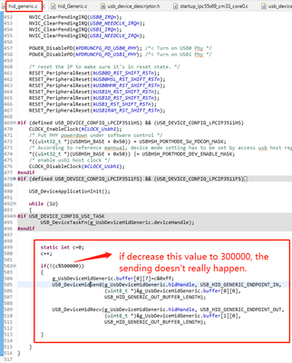

LPC55S69 SDK: Version 2.12.0.
example program: dev_hid_generic_bm.
USB speed: High speed port is used
Platform: LPC55S69 EVK
This demo receives an HID packet, and immediately sends it back. When I move the send function to the main loop, and want to send something to the host from the main loop, I noticed that it can only send very slowly: no more than 2 times every 1 second.
If I increase to call the send function (in the main loop) 10 times every second, the sending will be canceled in the sending function because of "0U != hidHandle->interruptInPipeStall".
question is: how to let the demo progam, send HID packets at a higher requency (such as 10 or 100 times every second) in the main loop?
