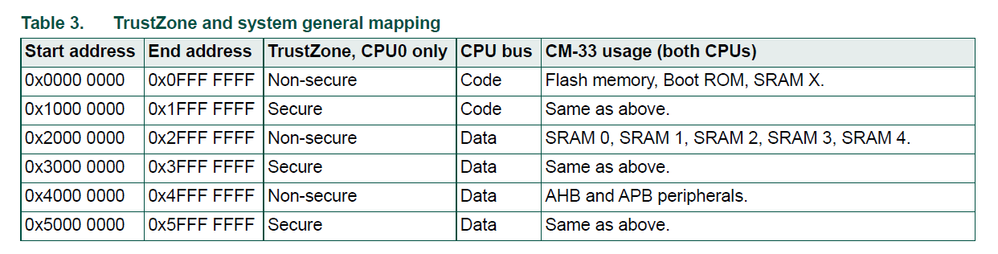

Hi !
I would like to simplify memory attributes configuration and decide to disable IDAU. Looks like it is redundant in common cases.
Do I understand right and in case of SAU I should specify only NS and NSC memory regions only ( non-secure memory address range are in use) ? Other parts remain secure by default.
I have added non-secure flash and sram , peripheral area and PPB area ( 0xE0000000 - 0xE003FFFF (256KB)).
After that MSW,MPC/PPC setting refine final access attributes.
Looks like I should specify peripheral area in SAU, because PPC can't enable peripheral usage on nonsecure side.
But PPB area definition in SAU looks like redundant and on user side in privileged mode I can enable/disable interrupts for example. Is any idea why PPB area looks out of "SAU" control ?

If you don't enable the region in "SAU memory regions", the default security is S. see below screenshot
If you enable it, you can only configure it as NS or NSC

This is LPC55s69 trustzone mapping, please define your region in given address range.

ZhangJennie
0xE0000000 - 0xE003FFFF is not in LPC55s69, why you configure this address?

ZhangJennie
PPB area is not displayed in the Memory Map view. It can be configured in SAU tab of the Security access configuration view, however the resulting access is not shown in the tool. The area 0xF000_0000 - 0xFFFF_FFFF is fixed as secure in both SAU and IDAU.

Besides,
0xe00000000-0xefffffff, by default SAU set it as secure. IDAU set it non secure. so overall, default is secure.
If you don't check region5, it's secure feature. So with this default setting, there is no error.
if you enable region5, set this region as non secure, you got HardFault error. Is this your problem?

ZhangJennie
By checking, PPB area includes ARM core registers. it can only be accessed with default secure setting. Please don't set it NS.
