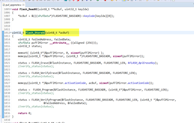

Yes, we need save the  AC to flash or ram by hand, not automatically.
1) I recommend you in development phase, save the AC in normal flash, not FPR, about detail
code, you can refer to  AN12324:
https://www.nxp.com.cn/docs/en/application-note/AN12324.pdf
https://www.nxp.com.cn/docs/en/application-note-software/AN12324SW.zip

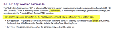

2)If you want to save AC to PFR, there is API, you mentioned is right,
"status_t FFR_KeystoreWrite(flash_config_t *config, ffr_key_store_t *pKeyStore)"

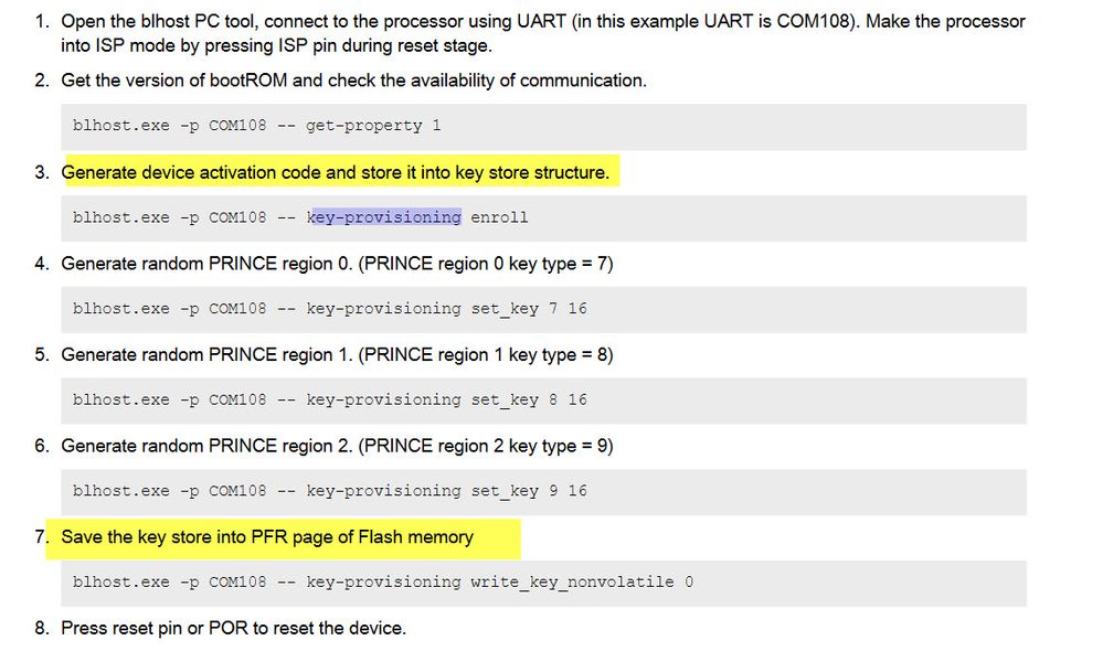

 this API is store AC and KC at the same time, there is no demo, while you can refer to the API in the AN12324. Also there is ISP command (key-provisionin)that can save AC to PFR, the AN12324 also mentioned this, you can check.
And you can also refer to https://www.nxp.com.cn/docs/en/application-note/AN12527.pdf , It describe the processing using blhost to use PUF:
Regards.

1) "Am I right that the AC is ALWAYS automatically stored in the PFR? And if I want it in RAM, I have to store it there extra?"
->> No, you can save it in PFR or RAM.
First of all, recommend you refer to the puf demo under SDK, you will have a better understanding of the processing.
Alice

Hello ,
Regards.
