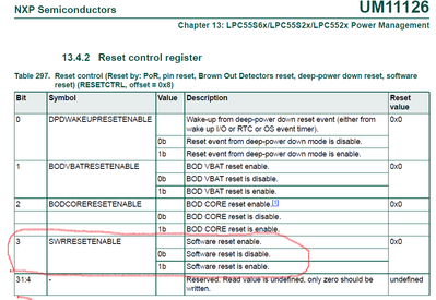

xiangjun_rong
As the following Figure, Pls set the SWRRESETENABLE bit in RESETCTRL register and have a try.
When you set the SWRRESETENABLE bit in RESETCTRL register to enable the software control, then write SYSCON->SWR_RESET to 0x5a00_0001, the software reset will be enabled.
XiangJun Rong

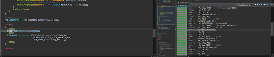

scottm
Senior Contributor II
Maybe you can help me understand what's going on here. I've set the SWRRESETENABLE bit and it executes the write to SWR_RESET. I've confirmed that r2 does hold the correct value of 0x5a000001. It doesn't reset, though, and continues to the next instruction - which for some reason is an infinite loop. I can't see why it would compile that way.
Edit: It looks like my immediate problem is actually on the P&E side. I've been generating an image of the bootloader for the Cyclone to load standalone, and then the debugger is set to preserve the bootloader range. Only the standalone programming algorithm is broken and isn't actually programming the bootloader area, and doesn't throw a verification error, so I've been repeatedly testing against an old version of the bootloader that was still in memory, probably loaded by an LPC-Link2 days ago.
Now the P&E burner crashes if I try to load multiple object files and the interactive programmer won't work, so I guess I'm back to the LPC-Link2 until P&E comes up with a fix. I'll try Erich's suggestion of using the gdb load command.
