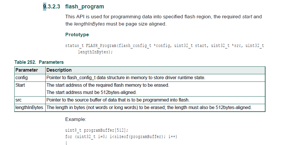

What is minimal data chunk what I can write to flash memory at once ?
8 byte block what is also 8 byte boundary aligned ?
What are constrains if PRINCE block is not used on certain 8KB flash block ?

As you know that the Prince module writes flash using the api function in ROM(IAP), when the PRINCE module is enabled, the data saved in flash is encrypted although the flash program function write sdata in plain text.
Because the flash page size is 512, so the flash-program should write flash in 512 bytes as chuck.
For the Prince module, the minimum sub-region size is 8K bytes, so the constrains if PRINCE block is not used or used must be in 8K bytes boundary.
