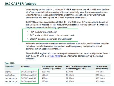

just see the  LPC55S69 support ECC function, does it mean include the ECDSA、ECDH support also?

Hi @Tedlai99
The LPC55S69 microcontroller includes hardware acceleration for ECC-based cryptographic operations through its CASPER and HASHCRYPT modules. These accelerators significantly improve performance for ECC algorithms, including:
- ECDSA (Elliptic Curve Digital Signature Algorithm)
Supported for signing and verification using secp256r1 curve.
- ECDH (Elliptic Curve Diffie-Hellman)
Supported for key exchange using secp256r1.
For more, see UM11126, Chapter 49 CASPER

Hi @Tedlai99
