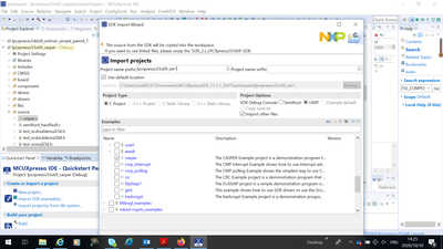

Hi, Eugene,
In the SDK package for LPC55S69, there is CASPER examples, which includes the RSA example and ECC examples. I copy the screenshot for loading the casper examples in SDK package. there is 256 bits and 384 bits ECC examples.
Hope it can help you
this is part of the code:
