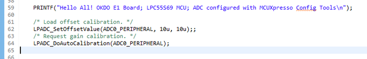

Good Day!
I am using an OKDO E1 board with the LPC55S69 MCU, Hardware 1B, developing with MCUXpresso 11.2.0 with SDK version 2.8.2(376 2020-08-19)
I have set up 6x ADC inputs from within MCUXpresso with the embedded Pheriperals tool of the CONFIGTOOL, instead of coding every ADC register in my own software.
Anyhow my project compiles and runs on MCUXpresso. (see attached  zip file)
BUT all the results that I read back from the ADC FIFO have the value 32768, even though my signal generator is correctly outputting the 6 sine waves into the ADC pins.
However if I FIRST run the lpcxpresso55s69_lpadc_polling example project, and then run my project, my project reads the correct values on the ADC inputs.
Telling me that I am missing SOMETHING CRUCIAL in the initialization of the ADC in my code, which is done in the lpcxpresso55s69_lpadc_polling example project.
Can someone please just check what it is that I am missing?

In this case it rather seems to be a pebkac error on my side and nothing wrong with configtools
I have not enabled the power to the ADC!
Added the following before the while (1) loop, and it now works
POWER_DisablePD(kPDRUNCFG_PD_LDOGPADC);

Thanks to you all for a great solution. I printed off the configuration code created by the tools in MCUXpresso 11.3 and compared it line-by-line with the example given in the project LPADC_Polling. I agree that the missing line is
POWER_DisablePD(kPDRUNCFG_PD_LDOGPADC); as gertvb suggests.
If I add it as he suggests to Main() then my ADC conversion works reliably.
I used the Peripherals tool to create and set up two Timers as well as the ADC. The ADC menu has options for power and doze mode but it does not create the missing line above. The Clocks peripheral tooldoes create a similar instruction in Board_BootClockPLL150M(): >
POWER_DisablePD(kPDRUNCFG_PD_FRO192M);
The Peripherals tool exists to configure the peripherals. Perhaps the next revision of the ADC Peripherals tool should automatically create the missing power-up instruction for the ADC.
