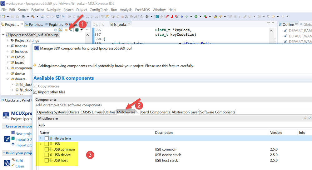

I'm trying to get our custom LPC55S66 board running as a USB high speed device.
I can build the LPCExpresso EVK examples, such as dev_cdc_vcom_lite_bm, and run them on the EVK board.  But I have not figured out how to run examples on our board.  Just changing MCU from '69 to '66 results in a project that won't compile as I mentioned in Help getting started .  And I've made many attempts to copy the code from the example project into a trivial project that builds and runs on our board, but it has too many compile errors.  It looks like the example code is designed for a different version of the USB drivers - functions have slightly different names or are just missing, etc.
How does one get started using USB?
I have enabled USB common and USB device in the Middleware SDK components.  Where are the APIs for these components documented?
Mike

HI Mike,
We normally suggest customer porting code to a usb sdk demo code because demo is more complex.
If you want to import SDK USB source file to a project, you can do it with SDK components management window
Hope this helps.

Hi, Jun,
With the advice from you and from Alexis in Help getting started I was able to modify the the dev_cdc_vcom_lite_bm example for high speed and run it on our board.  This really helps us start testing our board design, thanks!
So my main question right now is how to add USB code to an existing project.  I have created a simple project without any USB code that works on our board.  My attempts to copy code from the examples such as dev_cdc_vcom_lite_bm into my project have not succeeded - they are all compilation/build problems, not runtime problems.
I am not sure how this is supposed to work - should I copy files from the "source" directory in the example project and assume that the IDE will populate the necessary driver sources in the "usb" and "sources/generated" directories?

HI Mike,
Hope this helps.
