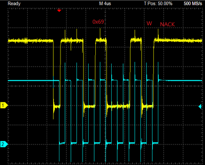

I'm running I3C on LPC5536-EVK and find out that I3C_BusMasterResetDAA(RSTDAA) doesn't seem to work for any of the sensors.
When we call I3C_BusMasterResetDAA, then It's always stuck for a while. We can see it stuck at fsl_component_i3c_adapter.c -> I3CMasterAdapterTransfer -> while (!g_masterCompletionFlag). The timeout for this call takes about 20 seconds.
This issue can be reproduced in Building an I3C Sensor Network Using LPC553x/LPC55S3x example. Add I3C_BusMasterResetDAA after the ICM42688P device enters I3C mode. See the attachment i3c_sensor_network.c.
if (demo_icm42688pDev != NULL ) {
  icm42688p_sensorAddr = demo_icm42688pDev->info.dynamicAddr;
  PRINTF("\r\nICM42688 Dynamic addresses is %d\r\n", icm42688p_sensorAddr);
  status_t result = I3C_BusMasterResetDAA(&demo_masterDev, icm42688p_sensorAddr);
  if (result != kStatus_Success)
      PRINTF("I3C_BusMasterResetDAA failed\r\n");
      return false;
  PRINTF("Finished\r\n");
while(1);
According to MIPI I3C® v1.0 (2016) . The format of a direct RSTDAA shall be:
1. S
2. 0x7E
3. 0x86 (Direct RSTDAA CCC)
4. SR
5. 0x09 (The dynamic address in this example)
6. P
However, we observe that the wavelet has a redundant byte after the Slave Addr.
1. S
2. 0x7E
4. SR
6. 0x00 (A redundant byte)
7. P

bell_huang
Hi Pavel,
Broadcast RSTDAA works fine for any sensors, but Direct RSTDAA does not.
See the wavelet of Direct RSTDAA of LPC55S36:
(1) S
(2) 0x7E
(3) 0x86 (Direct RSTDAA CCC)
(4) SR
(5) 0x09 (The dynamic address in this example)
(6) 0x00 (A redundant byte)
(7) P
From (1) to (5), devie responds well. However, the device is not responsable to respond (6) according to MIPI I3C® v1.0 (2016) . 
Not only ICM42688P, but any other device (including P3T1175) has the same situation.
Based on the two points mentioned above, I think the problem should be with the EVK or SDK, not the device.

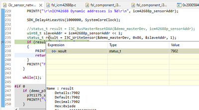

bell_huang
Hi @Pavel_Hernandez ,
This does not work. As I said, the first parameter of I3C_WriteSensor should be i3c_device_t*. It is weird to regard 0x7E as a pointer.
bell_huang_0-1709514834404.pngbell_huang_0-1709514834404.pngbell_huang_1-1709514840872.pngbell_huang_1-1709514840872.png
25,263 次查看
Pavel_Hernandez
Hello, sorry I have the other version of the example.
I3C_WriteSensor(&demo_masterDev, 0x86, &slaveAdd, 1)
Let me know if you have more questions.
Pavel
25,136 次查看
bell_huang
Do you have any updates for this message ?
25,251 次查看
bell_huang
I3C_WriteSensor(&demo_masterDev, 0x86, &slaveAdd, 1) doesn't work in i3c_sensor_network example. The first byte it drives is 0x08 and then NACK.
I3C_WriteSensor in i3c_sensor_network example is very different from in i3c_master_read_sensor_icm42688p example. In i3c_sensor_network example:
(1) The first parameter i3c_device_t of I3C_WriteSensor determines what it drives the first byte as the slave address.
(2) In this example, the dynamic address of demo_masterDev is assigned to 0x08, and the dynamic address of demo_icm42688pDev is assigned to 0x09.
That's the reason that I3C_WriteSensor(&demo_masterDev, 0x86, &slaveAdd, 1) drives the first byte 0x08, not 0x7E.
I test I3C_WriteSensor(0x7E, 0x86, &slaveAdd, 1) in i3c_master_read_sensor_icm42688p example, and it does not work too. Please refer to the attachment i3c_master_read_sensor_icm42688p.c for this test.

But if we call I3C_WriteSensor(0x7E, 0x86, &targetAddr, 1) for Direct RSTDAA, then it fails to read value using I2C. It means that the device does not be reset to I2C mode.
/* Direct RSTDAA */
uint8_t targetAddr = slaveAddr << 1;
result = I3C_WriteSensor(0x7E, 0x86, &targetAddr, 1);
    PRINTF("Direct RSTDAA failed\r\n");
    return -1;

Scenario 2
I don't get that I cannot use I3C_BusMasterGetDeviceInfo() or GETBCR/GETDCR/GETMRL like this. As I known Direct GETBCR/GETDCR/GETMRL are still available in I3C specification 1.1. Cannot I issue these commands at random time?
