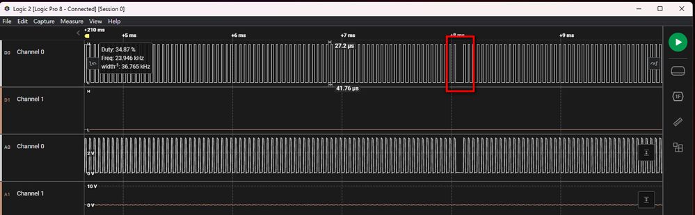

I'm testing the SDK example "lpcxpresso55s28_sctimer_pwm_with_dutycyle_change" and successfully generated PWM from pin P0_15(SCT0, OUT2).
But when i use my logic analyzer to see the pulse, i saw there are always an incorrect pulse every 4.17ms, please check my picture. Did anyone meet this issue?2023-12-20_182040.jpg2023-12-20_182040.jpg

Thanks for your quick reply. I apologize for not clearly explaining my point. When I use the purely SDK code to generate a pulse, the result is the same as yours, and it works fine. However, when I try to modify the code to generate a different duty cycle for each pulse individually, weird pulses occur frequently. It seems that the more frequently I update the duty cycle, the more frequently these weird pulses occur. I can't figure out why. Should I avoid generating pulses with different duty cycles one by one?

Hello, I have repeated the problem you mentioned, and there is no such problem. The SDK version I used is "SDK_2_14_0_LPCXpresso55S28.zip". The SDK example "lpcxpresso55s28_sctimer_pwm_with_dutycyle_change" was tested on the LPC55S28 development board, and the output pulse of pin P0_15(SCT0, OUT2) was checked with a virtual oscilloscope. The pulse was correct. The hardware connection is as follows:
Please see the attachment video for test pulse.

      Hi, I have checked the code and found that "/*Enable interrupt flag to update PWM duty cycle*/" is placed in front of "/* Update PWM duty cycle */", you can modify it and try again, please refer to the following figure:
      You can test the attachment project.

I still meet the weird pulse when i use your project and only modify the delay parameter from 80000U to 8000U, the shorter of delay will make weird pulse happen more frequently, could you try to modify the delay time to 8000U and chekc if you also get weird pulse?
