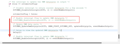

      Hi, I have checked the code and found that "/*Enable interrupt flag to update PWM duty cycle*/" is placed in front of "/* Update PWM duty cycle */", you can modify it and try again, please refer to the following figure:
      You can test the attachment project.
Best regards, Alex.
