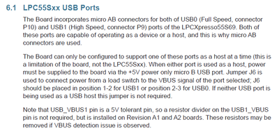

Thank you for your response.  The only text the UM has regarding USB on this EVM is this:

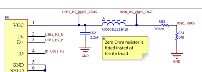

Since I'm not using Host mode, I have long since removed J6.  I also removed R84 (the pulldown in the VBUS detection circuit) which was populated on my board:
Any other hints?  I've tried two demo projects thus far and both have yielded the same failure.
