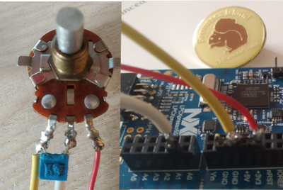

Starting from empty project I used peripherals configurator to enable ADC driver.
Then I connected the central of potenriometer to the A1 of P19 connector and the other two treminals to ground and +3,3V (as shown in the attached file).
Unfortunately the printed value is ADC value: 16384 regardless potentipmeter position.
I already downloaded the demo program lpadc_polling and it works perfectly.
Did you have any similar problem ? How did you fix it ?

Compare the generated code by  peripherals configurator with demo code, check whether need add some code by hand.

So how about development your own project based on the demo lpadc_polling ?
