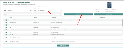

I can not find this example in SDK 2.9.1, can you check it?
6,317件の閲覧回数

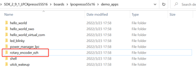

ZhangJennie
This demo exists on my side.
When download, please select "all toolchains" and "select all". check again
Jun Zhang

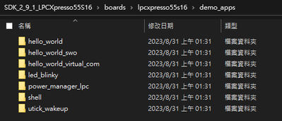

felix1
The example "rotary_encoder_ezh" is not in SDK 2.14.0, it seems just in SDK 2.9.1 and keil project type only.
6,282件の閲覧回数
ZhangJennie
Hi felix1
Yes, you are right. rotary_encoder_ezh is not included in SDK2.14 for LPCXpresso55S16. But it is included in SDK2.14 for LPCXpresso55S69
