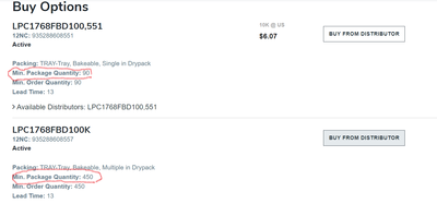

Dear Team,
May I know the difference of MCU: LPC1768FBD100,551 & LPC1768FBD100K
LPC1768FBD100,551 is used in our current design, right now this item is unavailable for the procurement.
Currently, LPC1768FBD100K - this part is available for procurement . So may I know the difference between both & whether any impact in the design.
Sheethal Sunny
1,195 Views
xiangjun_rong
pls refer to the website:
https://www.nxp.com/part/LPC1768FBD100#/
As the screenshot,the only difference is the minimum Package Quantity, one is 90 pcs, another is 450 pcs.
Hope it is helpful
