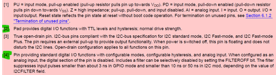

Question two: I am a bit confused, due to the connection of SWD signals. I do have the AN13707 and the datasheet, and NXP's MCUXpresso Config tool, V15.0, too.
Signal SWO is routed to PIO0_8 and also to PIO0_18. Which one is best to use? The debugger must work right at the very first power-up, because the first FW must be somehow downloaded into the processor.
Question three: How can I use the Tracedata signals? I don't see any example neither in datasheet, in RefManual or in appnotes, too. Aren't they necessary for debugging?

Pavel_Hernandez
Hello, I´m asking the internal department the first question I noticed the same the time analog is missing.
for the other 2 questions about the SWO, there is nothing special.
But if you want to use it for other purposes maybe this could interest you, the PIO8 (2) and PIO18 (4).
Let me get more information from the last question.
