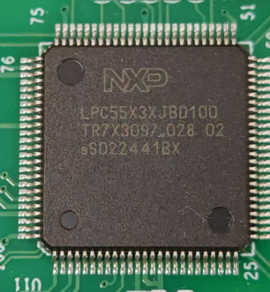

The chip silkscreen and DIEID (0x40000FFC) indicate that the chip version is 1B, but I don't know exactly which model number of the LPC55x3x. The register (0x40000FF8) is 0x501A11A1, but I can't find the corresponding model and package in the manual. Which model number does the Device ID refer to?

This is LPC5536JBD100 device. We will update RM. Sorry for the inconvenient to you.

Hello @lb_h
Could you please take a picture about the marking of your chip? And please tell where did you buy. Thanks.

lb_h
This is the silkscreen for the chip.

Hello @lb_h
