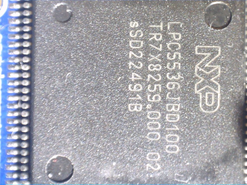

Hello @danielholala,
Would it be possible to share with us a clear photo of your MCU?
Best regards, Raul.

Hello @RaRo ,
here's the requested photo.
Hope that helps.

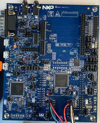

Could you please tell us your EVK's jumper settings? Could you take a picture of the board or tell us which jumpers are placed? Is the default jumper configuration in place or have you done some changes in any of the jumpers? Thank you.
Best regards, Raul.

Hello @RaRo ,
this is a picture of my board. I left most jumpers in default position. I only had to change two jumpers to enable I2C and SPI on MikroBus. I think those are JP51 (for I2C) and JP48 (for SPI).
 Hope that helps.
