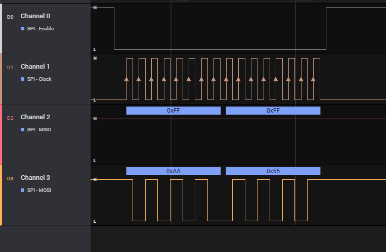

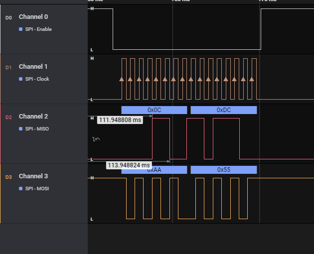

Hi, as the title states the MISO pin in multiple connector positions for the HS SPI (SPI8)
are pulled high by board and stay there even after SPI master init is called by all example programs including:
* spi_HS_LSPI_dma_b2b_transfer_master
* spi_polling_b2b_transfer_master
Also tested flexcom2  as SPI without merit.
General result: Misopin is always pulled high from the moment the board is powered.
The pin stays high even after calling SPI_MasterInit() function while other related pins get pulled to their setting. IE  CLK, MOSI pulled down and SS stays HIGH untill transfer is started.
 This results in miso always being read as 0xFF when reading a byte even when miso pin is disconnected.
Unconnected slave miso shows actual data from the slave device.
See results in Logic analyser below.
2bytes, miso with or without slave connected to miso pin. miso ALWAYS high.2bytes, miso with or without slave connected to miso pin. miso ALWAYS high.2 bytes, miso data read from slave while not connected to LPC55362 bytes, miso data read from slave while not connected to LPC5536SPI pins before and after SPI_masterInit()SPI pins before and after SPI_masterInit()
What am i missing here?

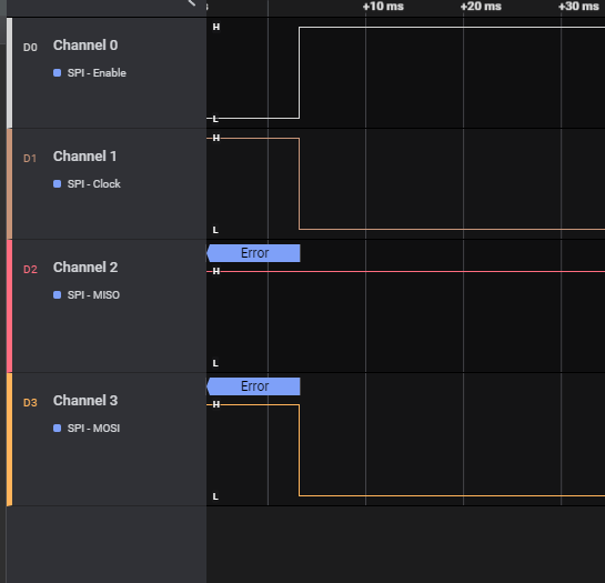

fr0stw1ng
To my knowledge the MISO pin of SPI as master is indeed an input.
Can i asume that you ment MISO in the second half of your post? Since your reply currently states the MOSI is both input and output?
Currently I treated the MISO pin as input and MOSI pin as output in all of my testing.
As seen on the attachements of my previous post, the Mosi pin displays data like its supposed too.
Its the MISO pin that stays high no matter the situation. (always 0xFF)
Even when the miso pin is only connected to a pulldown resistor(10k) I stilll receive 0xFF.
Its almost as if the MISO pin is set as an OUTPUT some how in all SPI example codes while it should be an input.
Checked example codes with 2 different boards with same result, All but MISO functioning on multiple spi interfaces (HS SPI & Flexcom2 as SPI)
Also played arround with the pinsettings in the pins configtool.
I tested the miso pin while specified as following:
Direction :: input, not specified, output
Mode :: inactive, pulldown, pullup
Invert:: disabled, enabled
Opendrain:: disabled, enabled
TLDR : Master In Slave Out stays high even while pulled down by resistor and/or changing available Pins configTool settings.

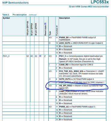

As the following screenshot, the PIO1_3 pin is configured as HS_SPI_MISO function, in other words, when the SPI is configured as master, the PIO1_3 is an input pin, when the SPI is configured as slave, the PIO1_3 is an output pin.
You configured the HS SPI as master, so the PIO1_3 pin function as input, you have to configure the PIO1_3 FUNC bits as 6. BTW, pls try to use 1 K ohm pull-down resistor, then check the data you have received.

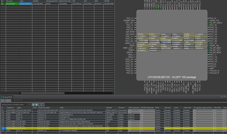

fr0stw1ng
Pin PIO1_3 was already setup as HS_SPI_MISO function with the configtool.
See provided picture.
Schermafbeelding 2022-08-01 152005.pngSchermafbeelding 2022-08-01 152005.png
As you can see the PIO1,3 pin has been setup as input.
In previous post i said that played arround with direction, mode, invert, opendrain  settings for the pin as well.
I currently do not understand what you ment by "you have to configure the PIO1_3 FUNC bits as 6.
As for the external resistor, placing a 1k didnt change anything.

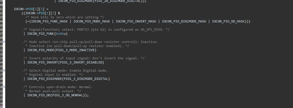

fr0stw1ng
The i found the following in pinmux already.
Regardless I tried replacing and adding both resulting in only the chipselect functioning, no more clock or MOSI and the MISO still high.
Note that i changed the provided function in your code IOCON_PIO_FUNC6 to IOCON_PIO_FUNC(6) since the function IOCON_PIO_FUNC6  was not found by IDE.
i've attached pin_mux.c for you.

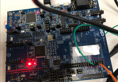

This whole time i thought i posted which board im working on....
The Board is: LPC5536-EVK.
The pulldown resistor is connected to ground on JP8 and the other end is currently only connected to the miso connection on JP7(PIO1_3)  and a logic analyser.
I've bridged JP57 didnt result in any changes on the misopin.

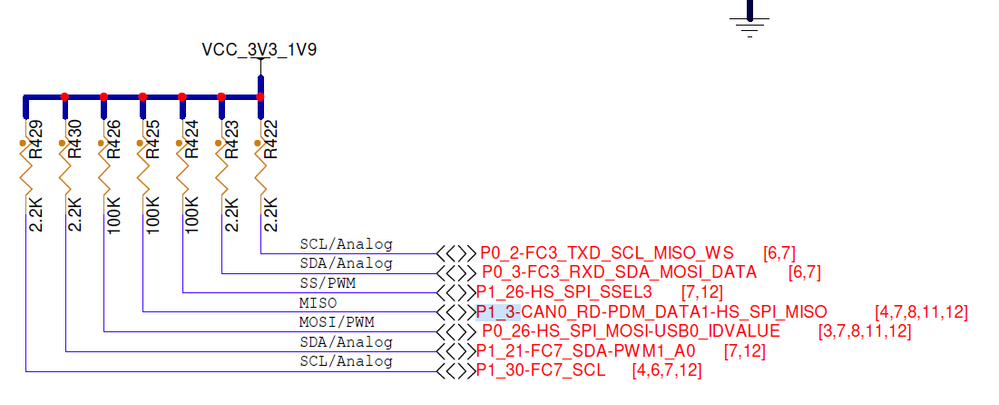

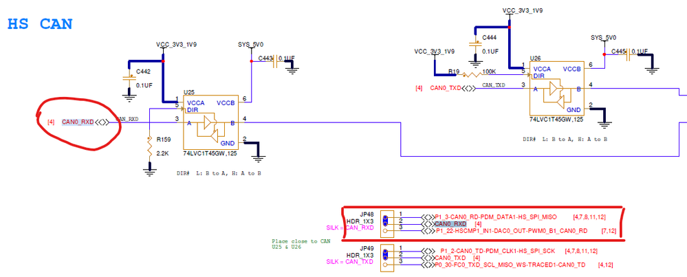

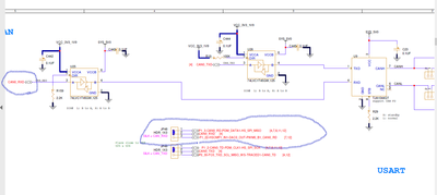

xiangjun_rong
As the following Figure, the P1_3-CAN0_RD-PDM_DATA1-HS_SPI_MISO is hardware connected to CAN0_RXD via JP48 which is driven by the CAN transceiver.
I suggest you cut the line of the JP48 and have a try

danielholala
Senior Contributor II
working with HS-SPI on the LPC5536-EVK, I have a similar observation.
Setup
The HS-SPI (Flexcomm8) is available through "mikroBUS" socket connector J7.
On MISO (Pin 5 @ J7), I measure 3,3 V. This is because MISO-Signal "P1_3" is pulled HIGH by R425, according to the schematic:
Problem
When I connect my SPI target (formerly known as "slave") and start a SPI transaction, MISO is pulled LOW by some unknown force. I don't know why this is. In any case, the target is unable to assert HIGH level on MISO.
Solution
Removing JP48 solves the problem.
Explanation: Through JP48, MISO is connected to CAN0_RXD and the devices connected to CAN0_RXD (i.e., U25) obviously hamper SPI communication.
Notes
Maybe it's best to remove JP49, too, although it was not required with my setup.
J57 is not populated on my board and thus open. This means the USB-to-SPI bridge via U24 is enabled (according to the LPC5536 EVK user manual). Still this did not interfere with SPI communication in my setup.
I don't know why NXP has decided not to mention this in the LPCXpresso55S36 Development Board User Manual.

Even while stepping through the program theres no activity on P1,3 only high.
Checked while JP57 is shorted and not shorted.
Checked all pins of JP48 just to be safe.

xiangjun_rong
You said that "Also tried adding function GPIO_PortToggle(GPIO,1,0x08);
to the while loop of the LED so the pin would toggle along side the led indefinitely.", as far as I know that the node "P1_3-CAN0_RD-PDM_DATA1-HS_SPI_MISO" is NOT connected to any LED, can you tell us which LED the node "P1_3-CAN0_RD-PDM_DATA1-HS_SPI_MISO" is connected?
You have to hook the pin1 of JP48 to a oscilloscope so that you can observe the signal.

xiangjun_rong
I retested the P1_3(pin10 of J92), I am sure it can toggle with JP57 is closed.
Note that the JP57 is not populated, you have to populate it with a jumper and close it.
I use the led_blinky in SDK as an example,pls check it.
