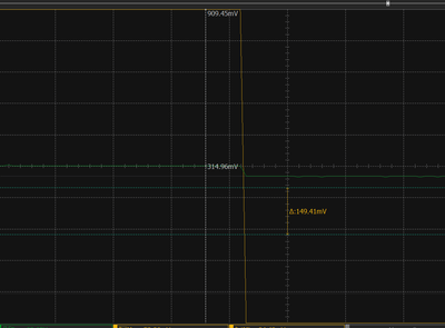

     1>LPC5536 PMW0 SM0 configuration
      2>Question
           "Immediate"  can't take effect soon when set LDOK ( LDMOD is set to 1), we can't find the reason.
      Thanks very much.

15,548 Views
明省徐
Hi,Alice_Yang:
    I test again in EVK board,but result is not except. result show in picture, Also use the project.
15,587 Views
明省徐
Hello,Alice_Yang
  I followed your steps, but the results were not as expected and were the same as the pictures I uploaded when I asked questions.
The mcu I tested is LPC5536, Can you share what your MCU is?
