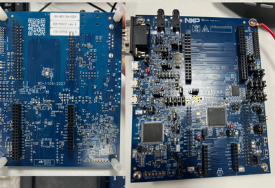

DEARS,
I used LPCXpresso55S36 test i3c port,use i3c port PIN 69,PIN 55, no clock and data.please help check if the demo is OK,or please help share a project about I3C TO USB application ,thank you.

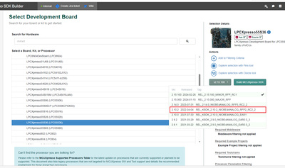

Harry_Zhang
Hi @luna_liang
您好,
请您在官网如图选择2.10 SDK 下载。

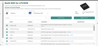

luna_liang
麻烦给一下您邮箱,thank you。
7,747 Views
luna_liang
2.10.2这个工程只有这个工程,选项里有I2C,没看到I3C module
这个是可以用吗

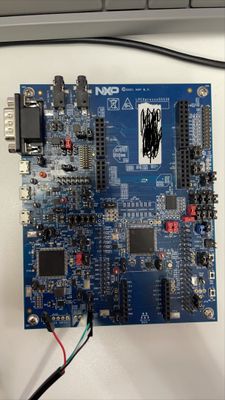

luna_liang
dear hang,
thank you,my demo has no R554,had read the read me doc,this need a short connect in R554_ PIN 2 TO PIN3,
SO can not run sussesful .
only to print: I3C master do dynamic address assignmentto the sensor slave.

Alex_Wang
Hi @luna_liang
You can download the 2.10.2 SDK by following the steps in the video.
Best regards, Alex

Harry_Zhang
Hi @luna_liang
你下载的应该是2.15的SDK,2.10的里面没有R554。
 下图为下载的压缩包,和 read me。我会邮箱发给你该压缩包。
