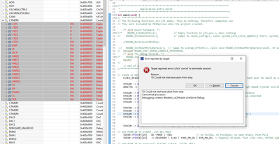

2- when I turn AHBCLKCTRLSET[1], bit26 to 1, I immediately loose the connection between MCUXpresso and MCULINK PRO. That means, I cannot debug anymore. I have to close the debug perspective and open it again.

4- In case I don't turn AHBCLKCTRLSET[1], 26 bit to 1, I can debug the chip, but all the instructions to set in the CTIMER0 section, they have no effect at all. I single step through them, but there's no change in the registers.
5- I also can't set to 0 the CTIMERCLKDIV[0] register - I'd like to enable the clock divider
6- CTIMERCLKSEL[0] also cannot select FRO1M, if I try to write this register 0x04, there's no effect.

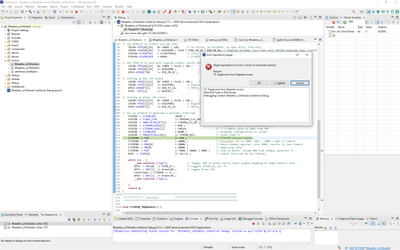

I discovered, that there's an error in the attached code. I corrected already from line 113 to 117, I access CTIMER0 now.
Now, my code compiles properly, runs until line 103 properly. From line 103 I single step. When I reach line 113 (CTIMER0->TCR |= CEN the connection breaks between MCUXpresso and MCU-LINK Pro. See the screenshot please. In case I don't single stem but run at full speed, the connection also breaks. I only try to watch a variable, CheckTimer. No other registers are watched.
How can I debug this code? Is it impossible?

My code runs until the breakpoint in line 103 without any problem. The first instruction is in line 77, there are only includes and comments before. The IRQ service routine is at the end of my code.

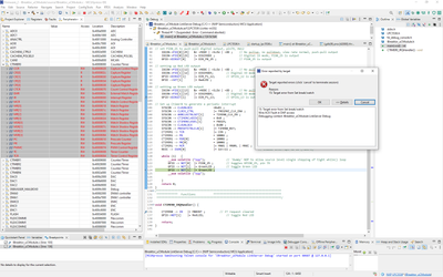

As I try to debug my code, I single step after line 103. Everything is fine, until I try to see the CTIMER0 registers. When the command in line 108 turns the clock ON, I immediately loose the connection between MCUXpresso and MCU-LINK PRO.
In case I don't watch the CTIMER0 registers in debug perspective, than I am able to single step through my code (IRQ doesn't come whether I single step or I let it run full speed).
If I stop the clock to CTIMER0 later in the code, I am able to look into the register-bank of CTIMER0, but I only see all zeroes there, like it wouldn't be configured at all.

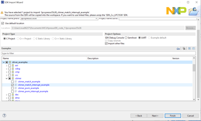

Pls refer to SDK example of CTimer.
You can download SDK from the link:
https://mcuxpresso.nxp.com/en/welcome
I suppose that the CTimer registers writing has to follow up a sequence.
After you enable the CTimer gated clock and set up the CTimer clock source, then follow up the sequence.

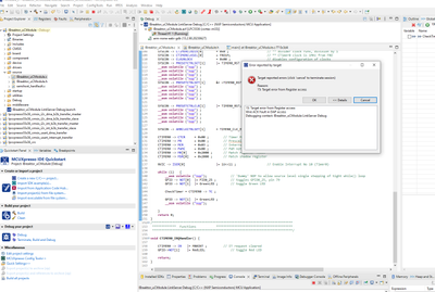

When the clock of CTIMER0 is enabled, line 128, I immediately loose the connection between MCUXpresso and MCU-LINK Pro.
I cannot find out, how to resolve this problem:
The only workaround is not to enable the clock for CTIMER0, by commenting line 128 out - see the screenshot please.
Of course, without clock, it is not possible to configure and run the CTIMER0. But, there's no loss of connection, the other parts of my code works.
I don't know what to do. Please recommend me a solution.

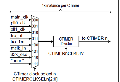

Whether the clock is enabled to CTIMER0 in AHBCLKCTRL[1], or it is not enabled, I cannot modify SYSCON-> CTIMERCLKDIV, cannot set the HALT bit to zero.
Also, CTIMERCLKSEL remains 0x07 (no clock), even if my code sets it to 0x00 (main clk).
When CTIMER0 clock is enabled in SYSCON->AHBCLKCTRL1, and I try to modify any registers in CTIMER0 domain, I loose the connection between MCUXpresso and MCU-Link pro.
Why I cannot select the clock source for CTIMER0? Is there any restriction to SYSCON->CTIMERCLKSEL0 ?

But, when I try to single step, at the moment I enable the clock for CTimer0, debugging is not more possible. The connection between MCUXpresso and MCU-Link Pro is broken:
It only happens when I try to watch the CTimer0 registers.
Is this the normal behavior of this setup, or there's still something wrong?

I have tried to run the void CTimerInit(void) code on my LPC5536-EVK board based on MCUXPrresso tools step by step,
I have not problem.
Maybe it is related to probe

The target of SYSCON->CTIMERGLOBALSTARTEN register is that all the CTimer modules can synchronize if they use the same clock as tick.
Ctimerx clock diagram for LPC553x:
Hope it can help you
