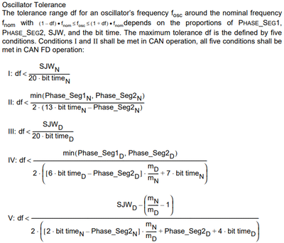

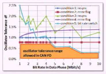

Regarding the oscillator tolerance, the 1.58% you mention applies only for a bus speed of up to 125kbit/s. For the full speed range you need to consider these conditions:
The parameters for the above conditions are given by your bit timing configuration and will result in a graph like this:
Hope this help.
