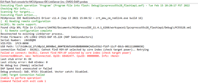

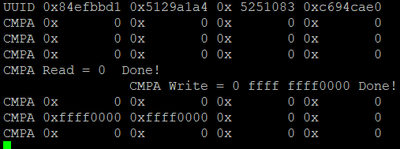

I was trying to enable flash protect on LPC55s28 with the solution marked as working from Erik_M and after reset I am unable to connect to the board, but the board runs correctly (I can see that on the UART output). This is the debugger output when trying to connect:
Output from the UART suggests that the CMPA page was written correctly:
On the other hand I've previously tried the code from original poster bas_v on custom hardware with LPC5528 it seems to be bricked after reset (on output on the UART, no LED turns on)...
Could you please help me with enabling the flash protection on these platforms?? Also is there a way to recover access any of this boards?

Cannot connect to target.
11,695 次查看
