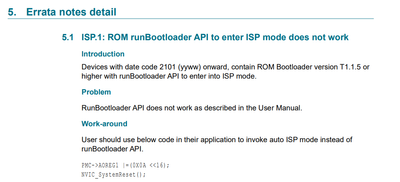

I am using the LPC5526 (NON-S) and want to re-enter the serial (uart) bootloader by a call from my program.
The ISP and SWD pins are not accessible (in the final product) and both will be locked out security bits in the future (to prevent possible readout).
Reading through the User manual: 9.3.4 runBootloader API  mentions exactly what i need.
However this does not work.
The example below doesn't respond to a serial program (tested with Flashmagic) and when i suspend the program it is halted in  an "HardFault_Handler"
If i use the alternative location from the fsl_iap the program just reboots.
And finaly using the undocumented NXP forum suggestion also just reboots.
Short: Is it possible to jump to the UART ISP bootloader direct from my program? or do i have to do something before jumping? like turning off interrupts?

xiangjun_rong
I suppose that this is a bug described in errata.pdf
Pls download the errata of LPC552x from the link:
https://www.nxp.com.cn/docs/en/nxp/errata/LPC55S2x_LPC552x_ES.pdf
I suppose that the PIO0_5 pin must be high when you execute the code:
PMC->AOREG1 |=(0X0A <<16);
NVIC_SystemReset();
Hope it can help you
XiangJun Rong

bwinter
Thank you for your fast response.
Indeed it seems the "undocumented" part was from the errata pdf clearly writing the issue of the not working API ISP mode.
I still don't know how i could miss that point from the ES as i often look for the latest version and scan for possible problems.
However the ES fix was also in my source and tested without success on one of our prototypes (development boards).
On our new boards we have a pullup resistor connected to the P0_5 pin and on those boards the ES fix works as expected.
Thank you!
