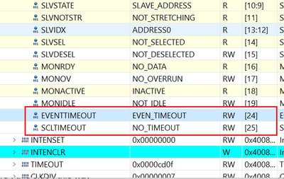

Harry_Zhang
Hi @danielholala
We found that if you enable timeout.
    I2C_MasterGetDefaultConfig(&masterConfig);
    masterConfig.enableTimeout = true;
    /* Change the default baudrate configuration */
    masterConfig.baudRate_Bps = I2C_BAUDRATE;
    /* Initialize the I2C master peripheral */
    I2C_MasterInit(EXAMPLE_I2C_MASTER, &masterConfig, I2C_MASTER_CLOCK_FREQUENCY);
After a brief drop in SCL, it will appear timeout.
You can check EVENTIMEOUT and SCLTIMEOUT status.
If timeout occurs, please reinitialize the master.image (4).pngimage (4).png

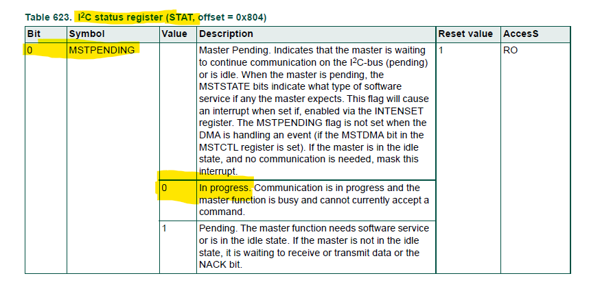

danielholala
Senior Contributor II
I traced the MCU executing a single I2C read command on an empty I2C bus after I had pulled SCL low briefly (when the bus was idle).
After  I2C_RunTransferStateMachine() handles state = kStartState, the I2C  peripheral is stuck with MSTPENDING == 0 in I2C status register STAT:
This is unexpected: The I2C peripheral should not stay in this state for a longer period of time.
Rather it should perform the I2C transmission on the bus, receive a NACK, then set MSTPENDING to 1 and convey the received NACK through MSTSTATE bits in I2C status register to the driver. Setting MSTPENDING to 1 triggers an interrupt which in turn calls  the I2C_RunTransferStateMachine().
As this does not happen, the driver remains in the "busy" condition and I2C is unusable from then on.
With this bug, the LPC5526 cannot support multi master operation on an I2C bus or am I missing something?
