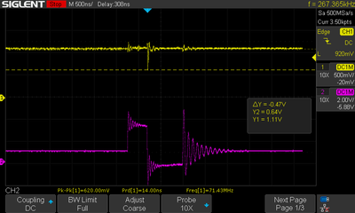

KumarG
Inductor used is SRP2510A-4R7M
Saturation current rating is 1.8A & rated rms is 1.36A
I have captured voltage before and after inductor, there is a large voltage spike on core voltage.
Kumar
1,864 Views
xiangjun_rong
The DC/DC voltage delta is very high, I suppose that this is related to the 22uF capacitor.
Pls refer to the 22uF capacitor feature in the AN
https://www.nxp.com.cn/docs/en/application-note/AN12325.pdf
Hope it can help you
XiangJun Rong
