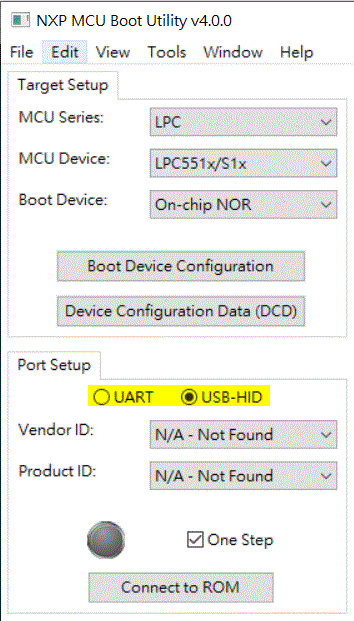

Hi Sir
If we modify the bootloader VID/PID,  and use MCU_boot utility to update the FW will fail.
Does the MCU_boot utility will check the VID/PID by USB?

If you modify the bootloader VID/PID, you need to adjust below args in \NXP-MCUBootUtility\src\targets\LPC55S16\bltargetconfig.py
romUsbVid = '0x1FC9'
romUsbPid = '0x0022'

Our customer use their EVT board, we provid the method(how to change bootloader VID/PID).
Their platform is LPC5514.

Add MCU BOOT Utility version.
Does the tool will check the VID/PID?(I know that there are at least 3 types)?

Does the tool will check the VID/PID? yes, it can check it
