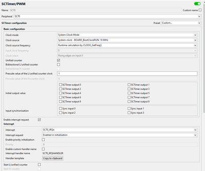

Hello I'm using the config tools to set up the SCT and I am having troble getting the IRQ to generate, even thou the counter is running and going passed the match value.
Config Screen Shots
Code generated

Hello paulsanders,
It seems the Event0 interrupt haven't enable in the generated code, please enable it by hand, then test
whether interrupt can work.

7,386件の閲覧回数
sanders7284
Thank you, that fixes the problem.
Thanks for your help.
Think it could be better documented in the SCT explanation in the user manual and also would be nice if the config tools showed you the evernt options not just the SCT IRQ.

sanders7284
Thanks Alice,
I can only see an IRQ for the SCT as a whole NVIC #12, where are the event IRQ held?
The only other place I can see to set this up is STATEMASKn, and this is already set up correctly.
7,339件の閲覧回数
As I said before "event interrupt enable register (EVEN)"
