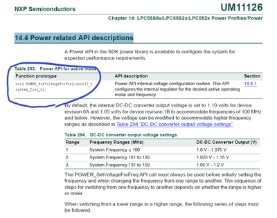

Pls refer to section 14.4 Power related API descriptions in UM11126.pdf as the following Fig
The function can set up the DC/DC output voltage which varies vs core frequency.

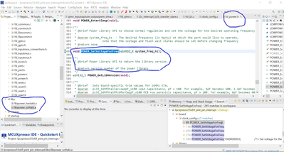

The function source code is NOT provided, we only provide binary code in the library as following fig
Hope it can help you

I think it is okay to configure the core clock to 12MHz or less, it is dependent on  the clock source frequency and divider. When the core clock frequency is less than 100MHz, the DC/DC converter output voltage will remain to 1.0V to 1.075V.
