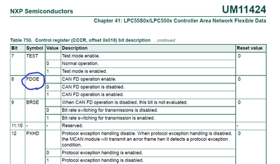

xiangjun_rong
The CAN controller of LPC550x can be both general CAN controller and CAN-FD controller which is dependent on the CAN control register configuration.
If the FDOE is set, this is a CAN-FD controller. if the FDOE is cleared, this is a CAN controller, flexible data rate is not supported.
Hope it can help you
XiangJun Rong

MartinHo
Thanks for the information.
If I understand You right, on the LPC5502 / LPC5504 / LPC5506 I have to set the FDOE bit to 0. while on the LPC55S04 / LPC55S06 this bit can be set to 0 or 1.
What happens if FDOE is set to 1 on the LPC5502/4/6?
It seem to me that there is no real difference between the "S" and no "S" version regarding the CAN Controller, apart from NXP guaranteeing only the CAN 2.0 mode as functioning on the no "S" MCU's.
I think this should be mentioned in the User Manual and/or the data sheet.

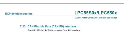

xiangjun_rong
I come to know your question.
Pls refer to section 7.25 in data sheet of LPC550x, both the LPC55S0x and LPC550x have CAN-FD modules.
Anyway, I will confirm with AE team.
XiangJun Rong
4,488 Views
xiangjun_rong
This is AE reply:
 LPC550x only support CAN2.0 since the CAN-FD feature is not available (not enabled) for this part.
XiangJun Rong
