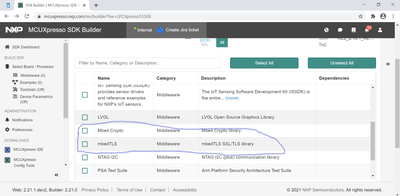

Pls download SDK package from the link for LPC55S06:
https://www.nxp.com/design/software/development-software/mcuxpresso-software-and-tools-/mcuxpresso-s...
Especially, you have select the mbedTLs and the mBed crypto items before you downloading, then the RSA function will be included. the code use pure firmware to compute RSA, it can get the E,D,N parameters and compute the RSA encryption and decryption.
