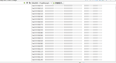

FLASH RANGE :0X0 - 0X20000
if i read the value of this address, The program will enter the HardFault interrupt function.
Every other chip I've ever used can read the data, as long as its address is in flash range
Why is LPC5504 an exception.
Has anyone come across it? Please help me. Thank you

May I ask if you have erased the flash and read it directly?
If so, please refer to this.
[LPC55xx] How to fix AHB Read HardFault Error - NXP Community
Hope this will help you.
