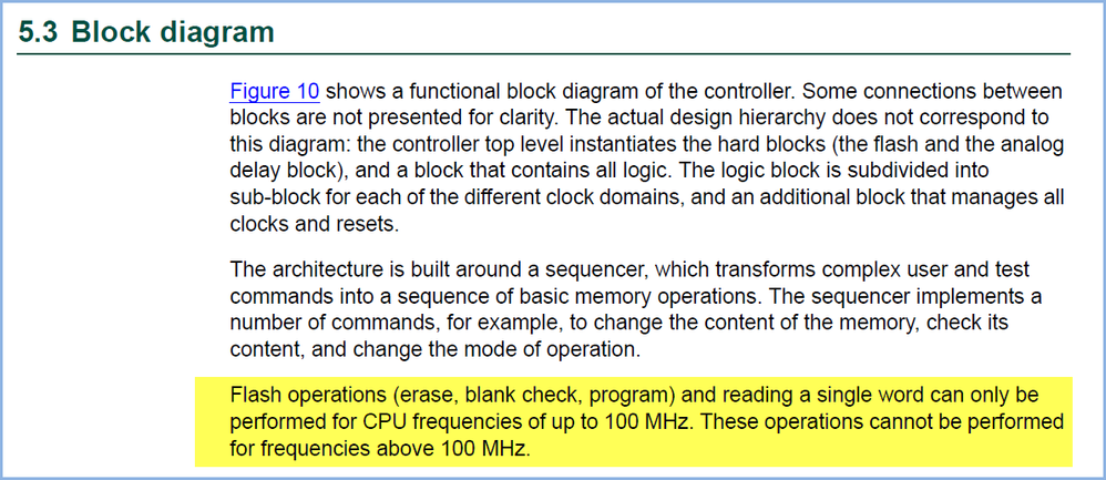

Does reading of flash memory via controller have clock 100 Mhz limitation aslo ? What about prefetch bit enable/disable ?
Or 100 Mhz rule is applicabli for Write and Erase operations only ?
Yes, see UM11126:
