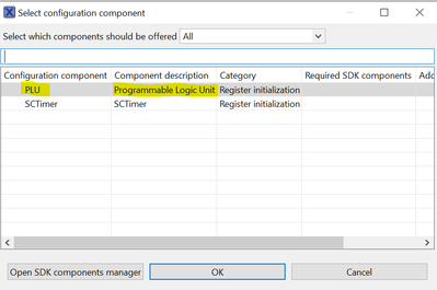

  1. Download MCUXpresso IDE v11.7.0, this is because PLU Tool in MCUXpresso IDE v11.6.1 is not working properly.
  2. Download the LPC55xx appropriate SDKv2.13.
  3. Create a new project or import an SDK example.

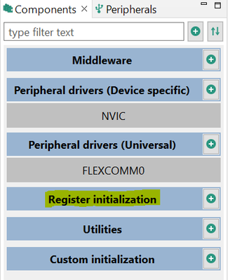

  4. Open ConfigTools -> Peripherals.
  5. Then, in Components section, go to Register initialization.
  1. A new window will open, please select PLU

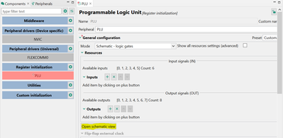

  1. Now the Peripherals window should look as below:

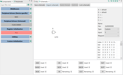

    Click on the Open Schematic View.
  1. Finally, go ahead and create your schematic.
