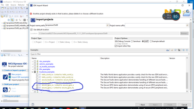

This a secure GPIO example in SDK package for LPC55S69, you can check the code:

xiangjun_rong
this is the secure GPIO example code:
Regard
