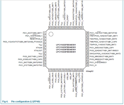

Hi, HerrPhy,
Pls download the data sheet of LPC11U2x from the link:
https://www.nxp.com/docs/en/data-sheet/LPC11U2X.pdf
Pls refer to the Fig 4, all the LPC11U22FBD48/301, LPC11U23FBD48/301,LPC11U24FBD48/301, LPC11U24FBD48/401 are pin to pin compatible, but only  the memory size are different.

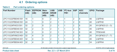

HerrPhy
Thanks for the reply. Can I use other serial like 11U34FBD48/421 or 11U35FBD48/401 to replace the 11U24 serial chip? Are they also binary code compatible?

xiangjun_rong
Hi, HerrPhy,
I have compared the pin assignment for the 11U34FBD48/421, 11U35FBD48/401 and LPC11U24FBD48/401, I think the pin assignment are the same, pls check again yourself.
Regarding the "binary code compatible" question, I am sure all of them are binary code compatible, because they use the same core ARM Cortex-M0.

HerrPhy
And also we don't wanna change the PCB so it should be a pin-2-pin compatible to LPC11U24FBD48/401
