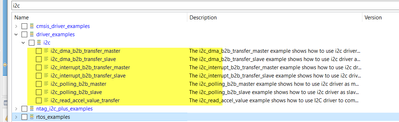

Hello christianlees,
The MCUXpressso config GUI not generate all the related code, you can compare the generated code with demo project code, check which code you need to add .
Alice
2,757 Views
Recommend you first refer to the I2C demo under SDK:
https://mcuxpresso.nxp.com/en/builder?hw=LPCXpresso55S06
