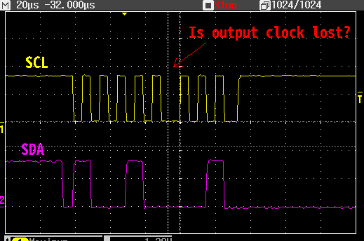

I encounted a problem that MCU output SCL is lost.(See below)
I want to know what is happons.
i2c_signali2c_signal

This bus hung up was occurr with driving high current near i2c bus. So we reduced effect of its line. Then, its not occurred.
What I'm wondering is SCL is generated by MCU peripheral on master transfer, but one pulse lost.

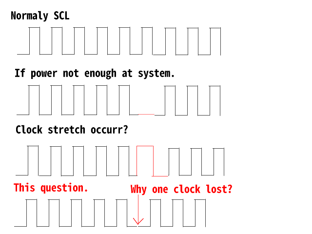

It's hard to explain in words, so take a look below.
We imagine one of the following.(This is just our imagination.)
  1. Driving clock of FlexComm was disordered by external noise.
  2. SCL change to L by external noise, clock is lost. Same time, clock stretch is occurred. One pulse of SCL was lost.
  3. If FlexComm is inteligently watch SCL line.
    FlexComm peripheral judged SCL high state is end because detected L of SCL just after release SCL.
    Peripheral change to next state (SCL to L). Therefore SCL is lost.

frank_m
Senior Contributor III
If that is true, than the issue is not related to clock stretching.
Rather the synchronisation and the ACK signal got lost.
Many I2C slave devices are simple state machines, and never re-synchronize without power cycle or other specific measures.

> I don't understand that it is possible for a slave device to shorten the cycle of one sequence (9bits=Addr+RW+ACK)..Because I don't think the duration of the sequence will change even if the slave device keeps SCL low.
Your understanding is correct so far.
The number of transferred bits does not change, as this is crucial for the functionality of the bus.
If only 8 cycles are visible, it is likely that the master catched and interpreted a noise spike as clock pulse.
For clock stretching, the slave keeps SCL low when he detects clocking issues. This protracts the transfer, but does not change the sequence of logic levels.
If you have EMV issues due to switching of high currents nearby, perhaps you can reduce the I2C clock frequency further, and/or add some RC lowpass filters to increase robustness.
