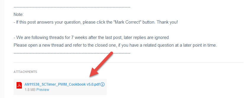

jeremyzhou
Hi Sergio Biasi,
Thanks for your reply.
I had already attached the AN11538 before, whereas they are invisible to you, it seems a bit weird.
Fortunately, you already got it.
