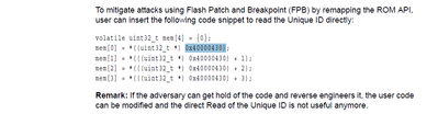

Hi, I run SDK's example "iap_basic" to retrieve UUID the value read from the MCU  is always 0. I tried on multiple board with 54S018M and the value is always 0.
SDK's IAP debug output:
When I inspect the memory location where UUID is stored at, the memory is always 0 also.
Per manual
Memory from the debugger at 0x40000430
Please advise how to retrieve UUID

I figured out the issue.
Where running the SDK example, the IDE  (KIEL) copy the image into SRAM and run. This is when UUID is always 0.
If I program the example into flash an run then NXP's BOOT ROM executes first and then passes control to the example. UUID is non zero.
So it looks like NXP BOOT ROM is setting things up to make UUID available to the application. This is not documented anywhere in the manual as far as I know.
